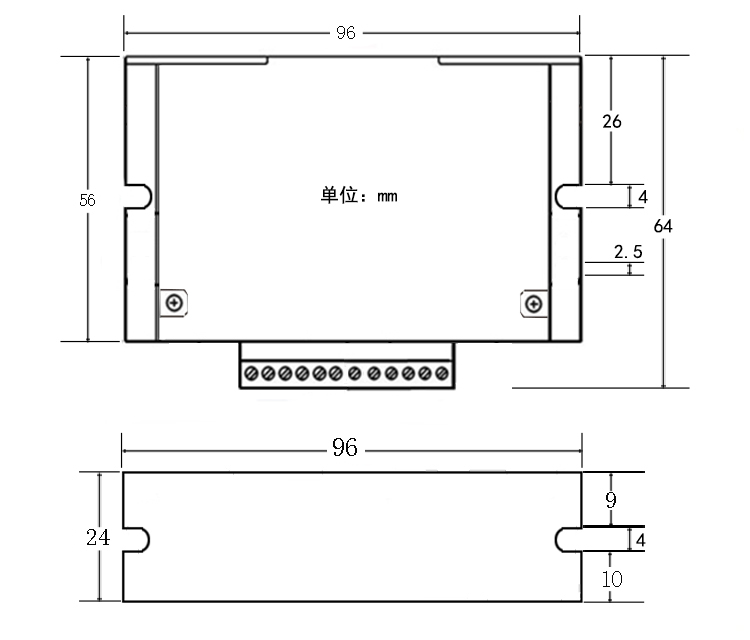

DM542C驱动器是一款专业的两相混合式数字式步进电机驱动器,可适配国内外各种品牌,电流在4.2A及以下,外径39,42,57mm的四线,六线,八线两相混合式步进电机。适合各种小中型自动化设备和仪器,例如:雕刻机、打标机、切割机、激光照排、绘图仪、数控机床、拿放装置等。在用户期望大电流、超静音、高细分运行的设备中效果特佳。

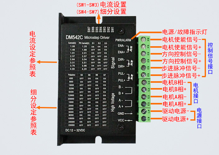

| 脉冲/圈 | SW4 | SW5 | SW6 | SW7 |
| 400 | OFF | ON | ON | ON |
| 800 | ON | OFF | ON | ON |
| 1600 | OFF | OFF | ON | ON |
| 3200 | ON | ON | OFF | ON |
| 6400 | OFF | ON | OFF | ON |
| 12800 | ON | OFF | OFF | ON |
| 25600 | OFF | OFF | OFF | ON |
| 1000 | ON | ON | ON | OFF |
| 2000 | OFF | ON | ON | OFF |
| 4000 | ON | OFF | ON | OFF |
| 5000 | OFF | OFF | ON | OFF |
| 8000 | ON | ON | OFF | OFF |
| 10000 | OFF | ON | OFF | OFF |
| 20000 | ON | OFF | OFF | OFF |
| 25000 | OFF | OFF | OFF | OFF |
| 运行电流/A | 峰值电流/A | SW1 | SW2 | SW3 |
| 1.00A | 1.20A | ON | ON | ON |
| 1.46A | 1.66A | OFF | ON | ON |
| 1.91A | 2.01A | ON | OFF | ON |
| 2.37A | 2.57A | OFF | OFF | ON |
| 2.84A | 3.04A | ON | ON | OFF |
| 3.31A | 3.51A | OFF | ON | OFF |
| 3.76A | 3.96A | ON | OFF | OFF |
| 4.00A | 4.20A | OFF | OFF | OFF |
